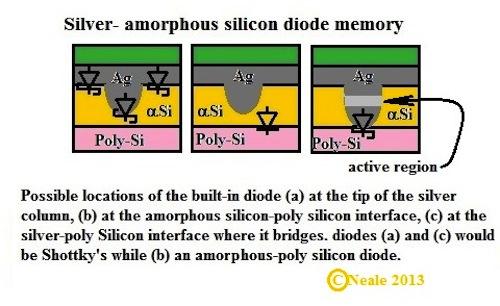

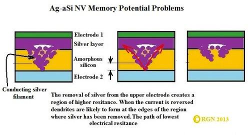

HI all,
Ron Neale asked me to include some graphics to support his comments below. (Honestly, this is the first time I've tried to insert figures, so here's hoping it works and is not, in the words of my teenage daughter, "an epic fail.")
The silver filaments figure (below) illustrates his concern
about the reliability of the Ag-aSi device.
This second figure illustrates his point about the need for an integrated matrix isolation device (i.e a diode).
Questions? concerns? Fire away!

Janine: here for the puposes of discussion is my list in my ranking order of potential next generation 2014 Hot Topic resistance switched NV memory technologies. The highest ranking must go to techologies that employ bulk, or pseudo bulk, switching effects and devices where the matrix isolating devices are integral with or can easily be produced with the meory cell structure. Demonstrations of devices with dimensions equal to or less than 20nm in matrix form are essential if the technologies are to stay on the list. This must include some realistic fact based indication of all electrical and environmental performance parameters that will allow the devices to outperfom Flash.

6) Ag-aSi, silver filaments in amorphous silicon I have my own questions on reliability and stability with scaling.
7) All other ReRAM types. Questions with respect to scaling,reproducibility and reliability. When the devices are scaled and the filament has the same cross section area as its contacts will the particular filament based mechanism work without the existence of material surronding the filament; can it operate as a pseudo bulk device.
