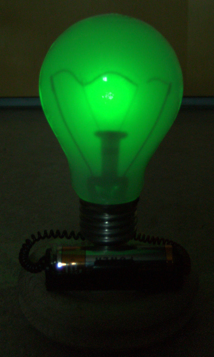

uwezi   1/22/2014 7:53:26 AM
NO RATINGS
When you glue the LEDs to the glass using transparent epoxy glue you will be able to create a light guide with matching index of refraction from the LED to the glass. This way you can get the light into the bulb without it reflecting off at the glass surface.
I have my own magic light bulb, which is a frosted, broken incandescent lit from behind with a green LED. The LED is attached to the glass with clean epoxy and the light appears to be coming from within the bulb - it almost looks like an X-ray image of the filament on an old fluorescent screen.
glowing broken incandescent lamp

Max The Magnificent   1/22/2014 11:22:29 AM
NO RATINGS
@uwezi: When you glue the LEDs to the glass using transparent epoxy glue you will be able to create a light guide with matching index of refraction from the LED to the glass. This way you can get the light into the bulb without it reflecting off at the glass surface.
Thsi looks great, but as you say it's frosted glass -- my problem is that my tubes are clear glass ... I'm still working on this...

uwezi   1/22/2014 11:58:54 AM
NO RATINGS
The glass on the light bulb is frosted on the inside... I still believe that glueing the LEDs should give you a better coupling of the light into the tubes as well. If you direct the light beam from an external LED through air at an obligue angle towards the tube, much of the light will be scattered off because of reflection at the glass/air interface. Glueing the LED to the glass effectively extends the clear LED casing to the inside wall of the glass tube and takes out two inhomogeneous interfaces: LED/air and air/glass.
